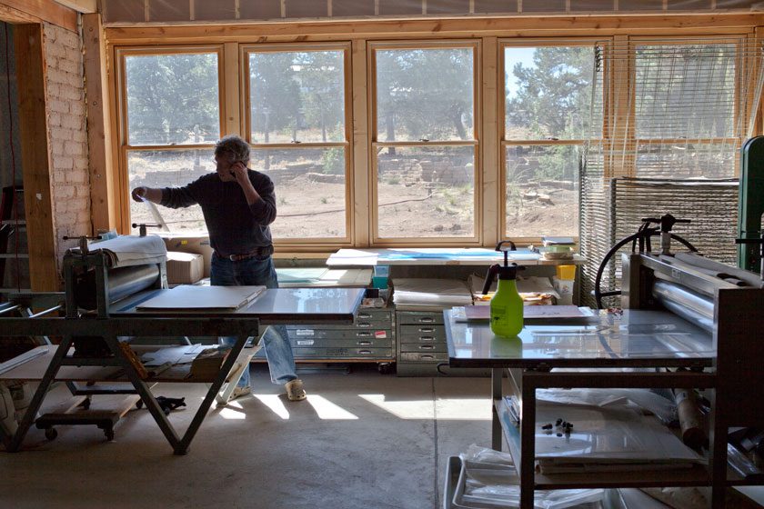

The studio is fabulously equipped. I expected to see an Amergraph exposing unit but found instead a huge production UV exposing unit that had two vacuum tables. There were two etching presses and enough workspace to accomodate up to 12 attendees for his “making art safely” printmaking workshops. If you are thinking about either cleaning up your printmaking act, or wanting to learn safe printmaking process, or how to get your digital images or hand painted images into etching ink – then you need to check out Making Art Safely.

Don built his own studio in Santa Fe, NM.

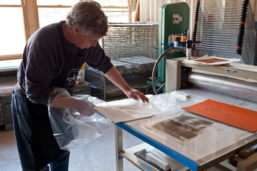

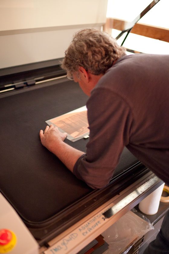

Don starts off the process by applying his standard curve to a grayscale image. He prints the image using ConeColor matte black ink on a special clear film. He prefers ConeColor matte black to the Epson matte black. :)
Don is able to work in daylight as long as know UV is present. His exposing room is bright but the UV is absent.

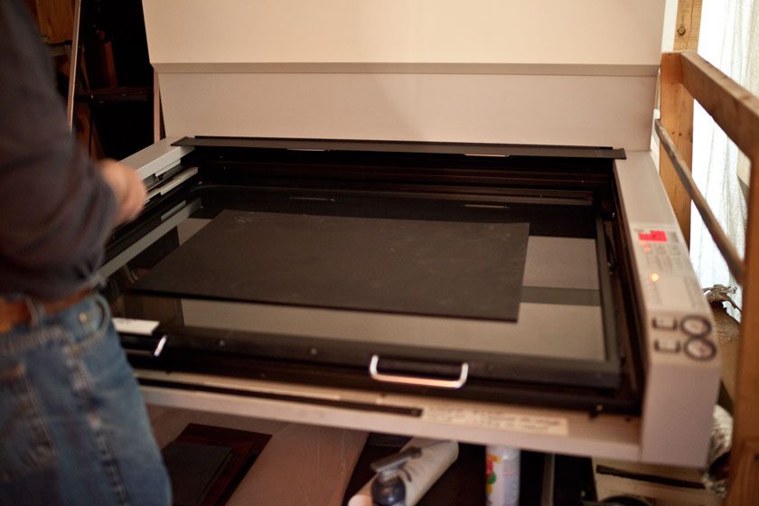

Don's dual vacuum frame upright UV exposure unit is the object of envy...although it needs a forklift to install it.
The development room is the same as the exposure room. No UV in this bright daylight. Don has filtered that out and the plates do not fog.

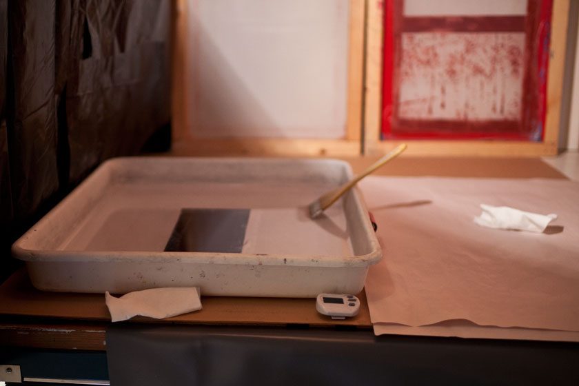

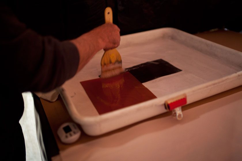

After exposing the polymer plate to the film positive, it is developed in water and agitated by means of a soft Japanese brush.
The plate is then rinsed and the amount of water used is incredibly minimal.

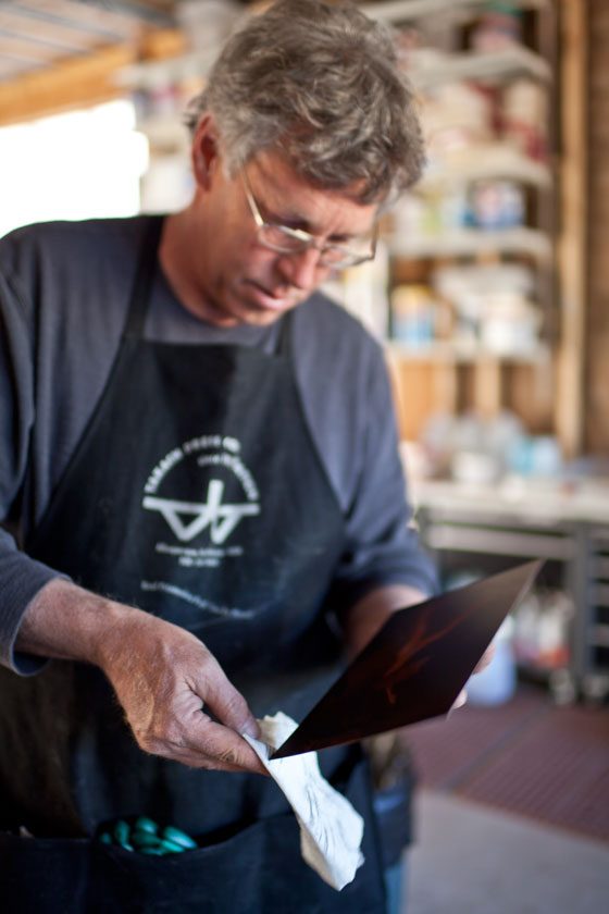

The edges are wiped clean. I remember doing this with a paper towel on my bare finger wetted with a keytone solvent...no wonder I got sick! Don only and always practices 100% non-toxic printmaking.

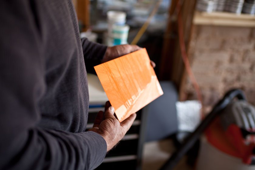

The finished plate carries the latent image exposed and developed in water and now ready for inking.

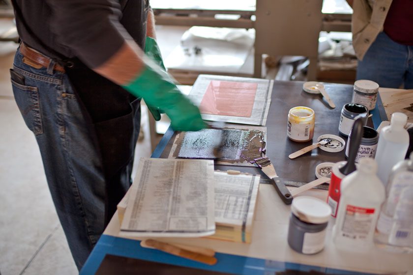

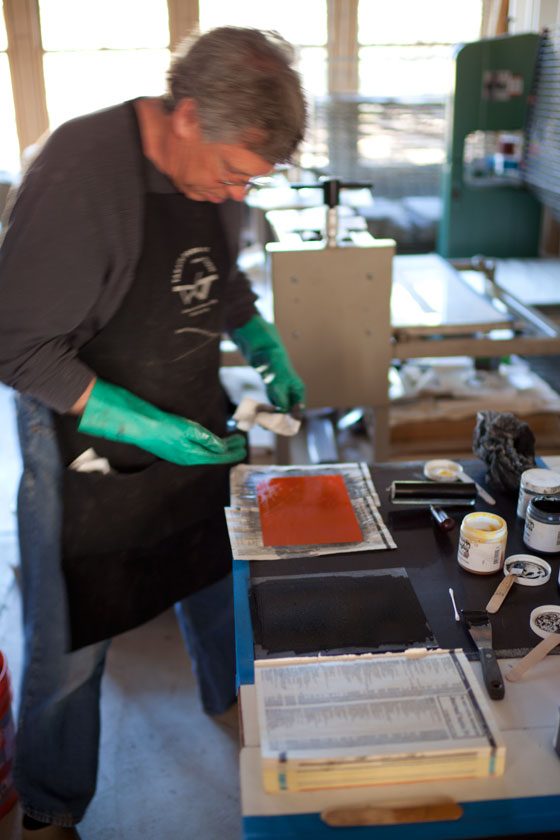

Don prepared the press bed. He cleans up the ink with baby wipes. What a difference from the Solvesso 100 solvent that made me so sick decades ago.
The water miscible soy-based ink is extraordinarily pigment laden. Some transparency is actually required to get a wider tonal latitude.

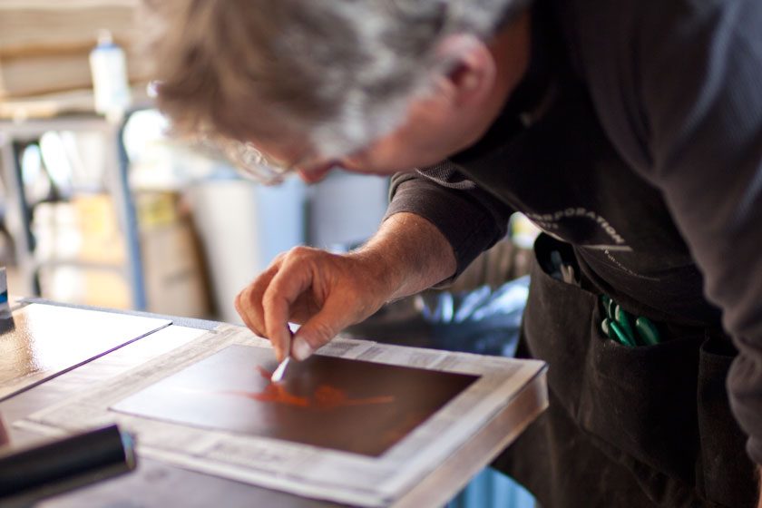

Hand wiping the plate after it is inked is very much in the traditional method of wiping aquatint plates. But, Don will not use his palms - always adhering to safe methods. Smart man!

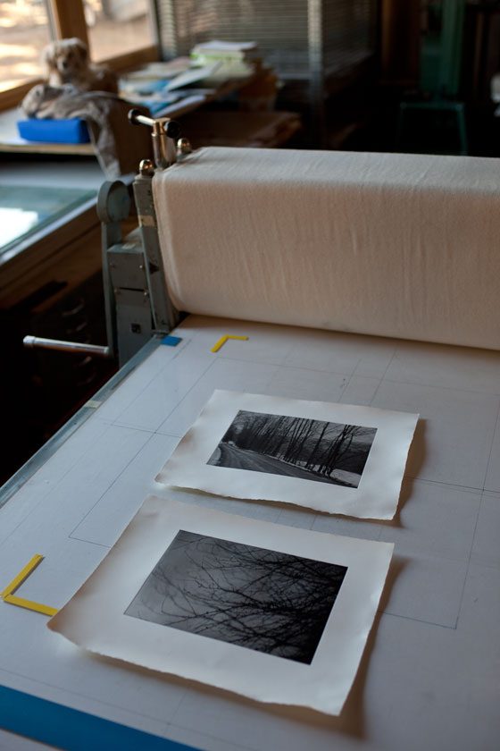

My print is pulled from the inked plate!!!
I worked with two images while at Don's studio. These are images which I have been printing recently with my own process. Photopolymner-gravure has a much more limited range of tone than Piezography. I will shoot differently for this process.
The entire process is overseen and directed by Don's dog Camas, who is named after a white root from Don's wife Charlene Teter's Spokane tribe. The root is used in a variety of ways.

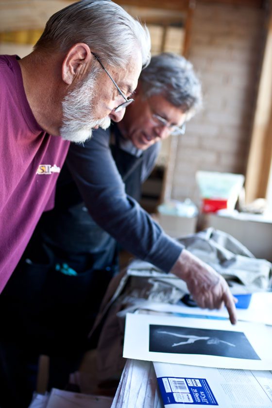

Don inspects his work. Gravure is an amazing process. The way Don uses his film process, the tone is rendered as if with aquatint. There is no discernible mechanical screen and the Epson dither produces a pleasing result.
