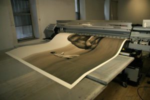

An 8 x 14 foot sheet of triple thick kozo/cotton being printed on a Roland 110" printer with 12 custom inks
I’ve been working with a handmade Japanese paper since 2006. Gregory Colbert introduced me to this sheet and asked me to make him a printing process for it and to print his exhibitions. It is extremely thick. I’ve probably printed more on this paper than any other human being. I’ve printed on nearly 200 sheets of this paper in a size that is 8 feet by 14 feet, and countless sheets that are 44×84. On a 110″ Roland printer outfitted with 11 monochromatic inks, a single image takes 16 hours to complete at the grand scale. Because it is unsized and without an inkjet coating, the printer can not pause for any auto-cleaning cycles, lest a drying line be left behind.
The varying thickness
This triple thick kozo/cotton blend is much too thick for Epson printers, and even too thick for Roland printers. But, I am able to remove the head plate, the capping stations, and the cleaning stations on my Roland printer, and modify them to raise the height (about two pennies thickness.) This paper is about 2.5mm thick by cross section, and has an extremely rough texture which can cause the paper to be 3.0 – 3.5mm thick in some places. Then of course the stray fibers, the natural bends and dips. The print head has to be way up high or expensive disasters “strike”.
The deckles are quite beautiful in the full sheets. It is exceedingly expensive. A single sheet of 8ft x 14ft weights nearly 15 lbs and costs $5,000. The smaller 44×84 sheets cost more than $300 each. But, I have several clients for whom I print their works on this paper. It is special order and has to be made by hand each time. So, I tack on a small supply of sheets for myself at the same time as I order for my clients. It can take two months to arrive. It’s always exciting. While my clients print one image at a time on a sheet, I tend to cut the sheet into may smaller pieces. I print small for myself. Still, it is scary making a test on even a $20 piece of paper.

For me, to solve the problems of printing on uncoated paper is to find a way that uses the paper for its soft and sumptuous quality that it imparts in and of itself. I don’t want to see ink sitting on top. I want to see paper impregnated with tone and color. That is what interests me. This paper’s surface is one of the most interesting in the world. It’s made by an ancient mill in Japan. It is history unto itself. It’s substantial in a way that both Western and Eastern papermaking have never previously aspired to.
The maximum density I have been able to attain is 1.42 using two blacks and pre-heating the paper to 50 c which is about 122 f. The Ashes and Snow prints that I produced were waxed by hand afterwards. That process increased the dMax considerably nearer to the 1.65 point. But, it adds a patina which I am not interested in my own work.
